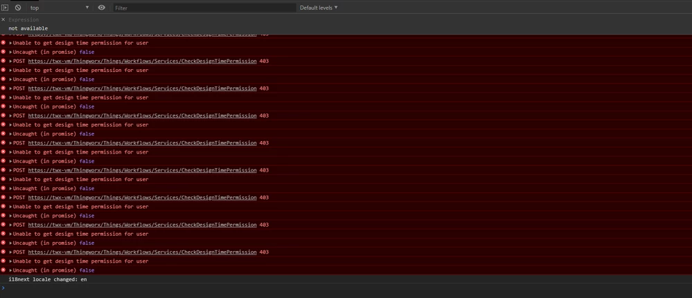

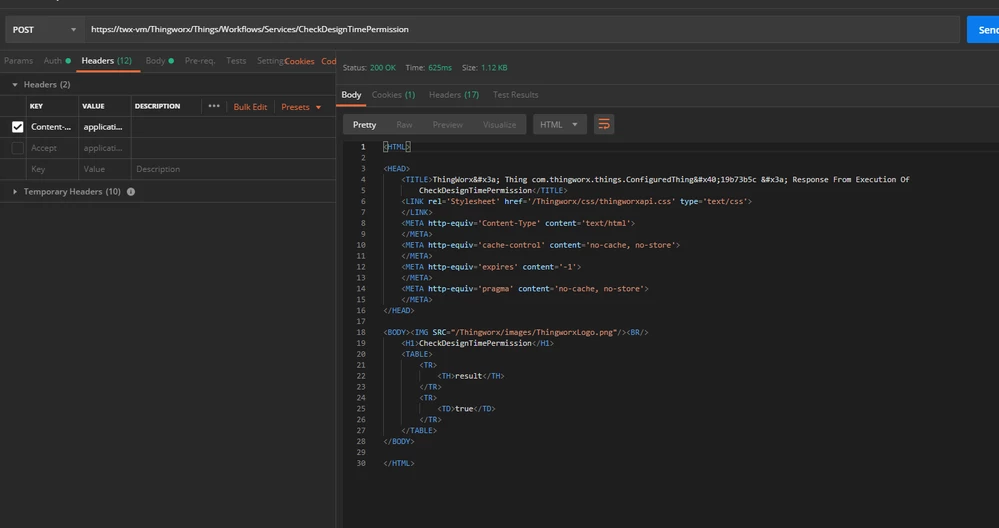

PFA the log files and also found below error in inspection window
But when I try to call service using postman I'm not getting any error. PFB PNG

Thanks for sharing.
Please can you attach <Tomcat>\webapps\Thingworx\WEB-INF\web.xml file?
