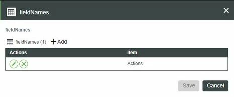

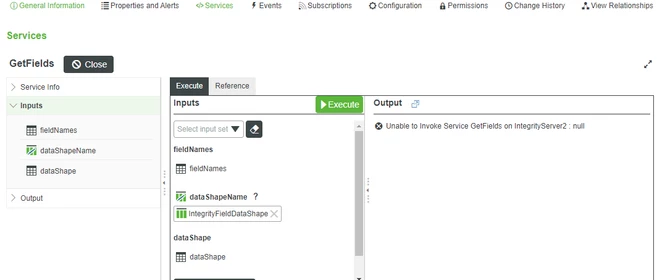

I am trying to execute one service called GetFields which exist as a part of integrity connector.
I am not able to understand the input set. I have created a custom data shape for data Shape name input field. Also provided on field name in field names input.1.JPG

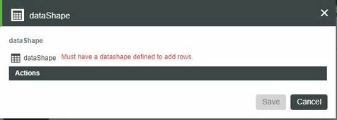

Now what needs to be provided for last dataShape Field. When i click it it gives me error : Must have datashape defined to add rows.

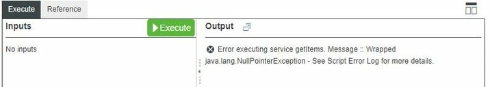

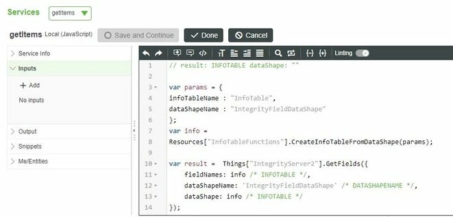

I also tried to create a wrapper thing to call this thing's services but no luck there as well. I get Nullpointer exception.

Hi @vkuma5.
Have you taken a look at this page from the ThingWorx Help center?
If you're not able to find the answer to your question, please let us know and we will research it.
