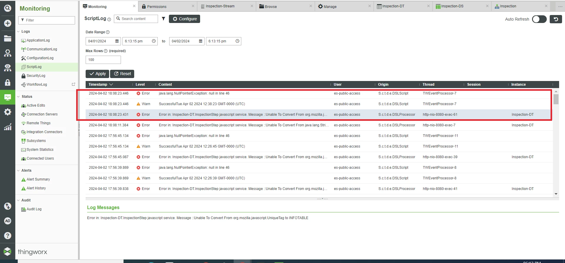

I want to store data into ThingWorx Stream (Inspection-Stream).
I have written a service in ThingWorx Datatable (Inspection-DT) to add data into stream
Code:
try {
// Your whole code here
// tags:TAGS
let tags = new Array();
// timestamp:DATETIME
let timestamp = new Date();
// values:INFOTABLE(Datashape:Inspection-DS)
let values = Things["Inspection-Stream"].CreateValues();
values.PartNumber = me.PartNumberProp; //NUMBER
values.StepNumber = me.StepNumberProp; //STRING
values.StepDefect = me.StepDefectProp; //STRING
//values.GUID = undefined; //GUID
values.StepImage = me.StepImageProp; //IMAGE
values.StepStatus = me.StepStatusProp; //STRING
values.EmpID = me.EmpIDProp; //NUMBER
values.DateTime = Date.now(); //DATETIME
// location:LOCATION
let location = {
latitude: 0,
longitude: 0,
elevation: 0,
units: "WGS84"
let params = {
tags: tags,
timestamp: timestamp,
source: me.name,
values: values,
location: location
// AddStreamEntry(tags:TAGS, timestamp:DATETIME, source:STRING("me.name"), values:INFOTABLE(Inspection-DS), location:LOCATION):NOTHING
Things["Inspection-Stream"].AddStreamEntry(params);
} catch(err) {
logger.error(err.message + " in line " + err.lineNumber);
I want to execute the above service through a subscription which is triggered whenever a property (DateTime) changes below is the service (AddData) written in Subscription
Code:
if(eventData.newValue.value){
me.InspectionAddData();
logger.warn('Successful'+eventData.newValue.value);
The output is giving an error, I have attached the error file.
Please help me out.
Thanks in Advance.

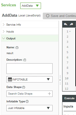

Can you please check the service output type is "Infotable"? If no results need to print out of service then make it with "Nothing",
Also, Try to execute the service manually to check the error.

Hi @Arun_C
The output of my service is set to nothing as the service just adds data to the table.
Aditya Gupta

Apr 2, 2024 3:20 PM UTC
Things["Inspection-Stream"].CreateValues(); will create an Infotable.
Your subsequent code is not how you add a row to an infotable.
You need to create an object, set the property values on the object, and then call AddRow with the object on the infotable.
Discussed here and here

What does this have to do with manual execution?
You posted code saying it gives you an exception and I gave you an explanation why.
The document in the second link even has chapter literally called "Adding an object based on a DataShape to a Stream"
