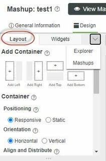

Hello Team,
I have migrated from thingworx 8.5 to 9.0. While designing mashup unable to find layout widget in responsive container. Please do the needful.
Raghavendra
yhanAnswer
Apr 14, 2021 8:36 AM UTC
Hi @RH_9350500,
Start from TWX 9.0, we use the layout tab to replace the same function with the layout widget:
/Yoyo

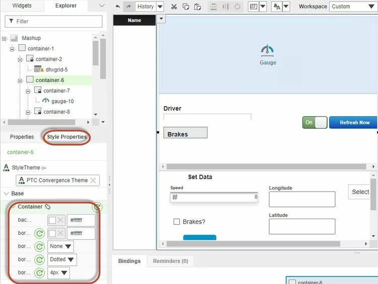

Hello Team,
How to add spaces between two vertical containers or horizontal containers in Thingworx 9.0.
In previous versions, we have property called spacing. I could not find in the latest versions.
Apr 15, 2021 8:56 AM UTC
Hi @RH_9350500,
Please try below border settings
/Yoyo
