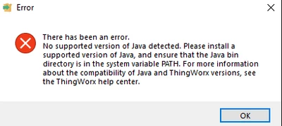

Not able to Install ThingWorx getting following Java Error
  • January 6, 2022
  • 900 views
Hello ,
I am trying to install ThingWorx 9.2 and already have java 8 in my system , still i am getting following error and not able to install ThingWorx.
I would appreciate quick resolution or help here.
Sudeep
Best answer by bchaudhary_448008
Hello @SY_10165961 ,
The supported Java version for 9.2 is Java 11.
Kindly install Java 11 and then you will be able to troubleshoot the issue.
Please refer following help centre guide for your reference.
https://support.ptc.com/help/thingworx/platform/r9/en/index.html#page/ThingWorx/Help/Installation/thingworxfoundationinstallerforwindows.html#
Regards
Bhawna
