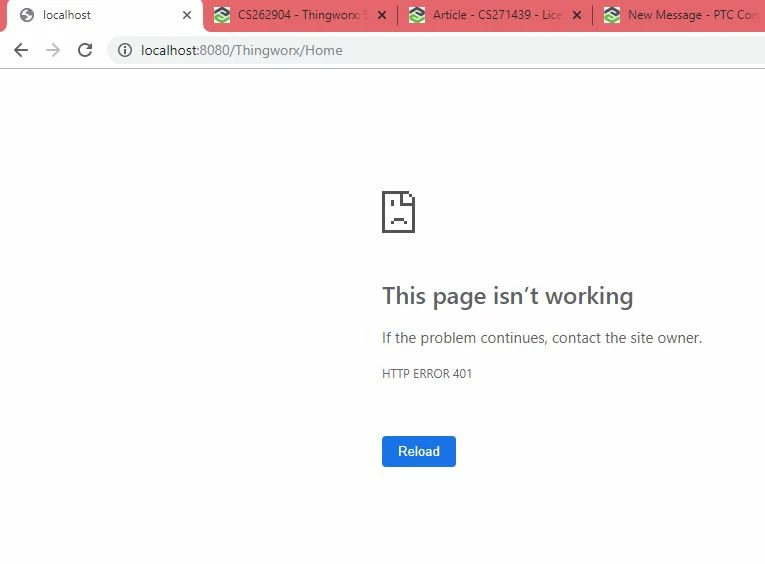

Hi Folks,
I have installed TWX 8.3 as per the Guide but not able to Load Composer page and getting 401 error as shown below in the attached snapshot.
I have gone through all the similar posts on the community but no luck in my case. I am guessing its related to DB but not sure and thus need your help to fix this.

-->Tomcat is working perfectly fine.But whenever I try to load thingworx get error. I suspect point number 6 above, with 57 tables and against 58 tables. but I didn't get any error after scripts execution.

2019-05-14 17:39:58.043+0530 [L: ERROR] [O: c.t.s.a.AuthenticationFilter] [I: ] [U: ] [S: ] [T: http-nio-8080-exec-1] Could not handle request
2019-05-14 17:40:17.103+0530 [L: ERROR] [O: c.t.s.a.AuthenticationFilter] [I: ] [U: ] [S: ] [T: http-nio-8080-exec-5] Could not handle request

Your suspect is correct ,there are 58 tables in 8.3 .Can you also share the screenshot of pgadmin showing the DB/Schema and number of tables ? As it seems the root cause is the connection between DB and application.

I reinstalled PostgreSQL and now able to see required 58 tables in the schema but Thingworx still not loading  with same error .
Log files attached.
Can you please attach screenshot from pgadmin showing no of tables under the DB ?
