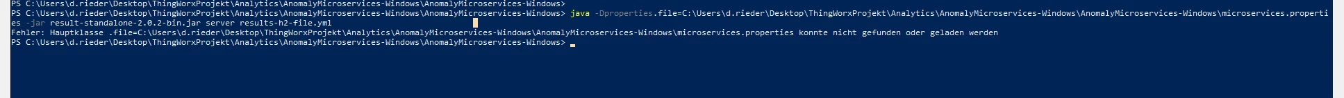

Hello everyone,
so I am following this guide to deploy the Anomaly Detection Service. I downloaded the AnomalyMicroservices-Windows and extracted it in the path
C:\Users\...\ThingWorxProjekt\Analytics\AnomalyMicroservices-Windows
So I ran the following command after I navigated to the extracted files directory:
java -Dproperties.file=C:\Users\...\ThingWorxProjekt\Analytics\AnomalyMicroservices-Windows\microservices.properties -jar result-standalone-2.0.2-bin.jar server results-h2-
file.yml
But I get the error "Main Class .file=C:\User\...\ThingWorxProjekt...\microservices.properties could not be found or loaded"
I also tried to not write the whole path but only \microservices.properties since I am already in this directory.
Any Ideas how I should do it properly?

May 23, 2018
Hi
The error report it cannot load a class, while we are specifying this as an argument to load a file, so it does not seem that the java command "understand" the argument and takes it as being the path to a class.
This can happen when  a copy paste is done and some corrupted character are pasted.
Could you try retyping the java -Dproperties.file= part instead of pasting it from somewhere ?
I am guessing the - character is not what it looks like and is not interpreted correctly by the java command.
Hope this helps
Christophe
drieder1-VisitorAuthor
May 23, 2018
Hi Christope,
thank you for your reply, but typing everything by hand didn't resolve the issue.
This is how it looks in powershell, the .file after -Dproperties is highlighted so I guess it recognizes it as a command parameter
May 23, 2018
Hi David
Could you execute the same command in a command prompt instead of a power shell.
I do get this error when I run in power shell, but it works for me in a command prompt.
Christophe
