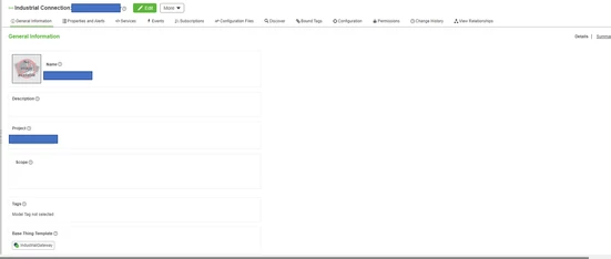

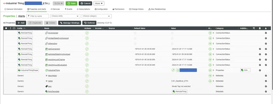

i have upgraded the thingworx from 9.3 to 9.5. i have created industrial connector thing for kepware connection its showing connected status. but when I create Edge thing with industrial connector as
as industrial thing ,status of that Edge is showing disconnected. Am i missing something here in binding or settings?

nop...it got resolved automatically ...which is surprise to us well ... may be some permission issues from clients IT team ..not sure

i can see kepware thing(industrial connector) is connected in my instance.
but the Edge thing which i created using industrial thingshape is showing disconnected status.
i followed this procedure to do connection
https://community.ptc.com/t5/IoT-Tips/Connect-Kepware-Server-to-ThingWorx-Foundation-Part-1/ta-p/809423
