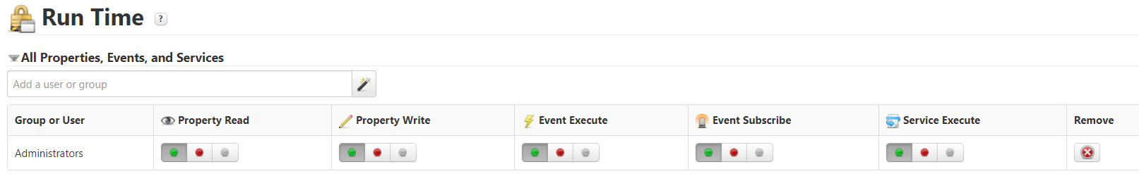

I used kafka, but when I assign a value to a property, there's an error:com.thingworx.common.exceptions.InvalidRequestException: Not authorized for PropertyWrite on strvalue in TestReceiver
@ThingworxPropertyDefinitions(properties = {
@ThingworxPropertyDefinition(name = "strvalue", description = "", category = "", baseType = "STRING", aspects = {"isReadOnly:false","isPersistent:true"}) })
setPropertyValue("strvalue", new StringPrimitive(results));
Please help me solve this problem.

For the User that is doing the Write, did you verify permissions for Runtime Property Write in the platform?

My user is Administrator

When you look in the Application Log in Thingworx, does it show that same error and Administrator as the user?
