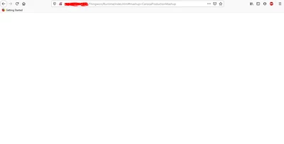

I'd like to see the mashup set as HomeMashup of the user, Gave the visibility and run time permission of things included in mashup to the user, but not able to see the mashup.
And seeing following message
[message: Entity Not Found : [PlatformSubsystem]]
Gave the organization visibility permission to PlatformSubsystem
solved ---> [message: Entity Not Found : [PlatformSubsystem]]
Now Getting --> [message: Entity Not Found : [Base Theme]]

February 17, 2020
Thank You @raluca_edu ,
Now that error in Application Logs has been resolved.
But ....
