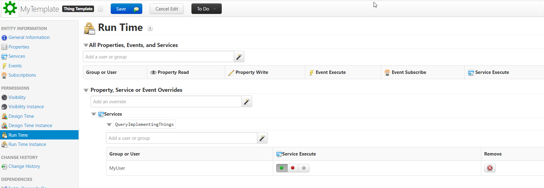

I have the same issue. I'm calling:
var things = ThingTemplates["MyExampleTemplate"].QueryImplementingThings();
However, when I check MyExampleTemplate (-> Run Time Instance), there is no QueryImplementingThings service available (in the Generic Services). Which Thing / Template should I modify to give the permissions? If I run that as an administrator, it works, so I guess the QueryImplementingThings is implemented somewhere.

Hello all,
In your case, all you need to do is to go to the Run Time instance of your Template and add permissions for this service (NOT Run Time Instance):
Jakub.
February 27, 2017
Hi Jakub,
Thanks. That worked for me. The "instance" mentioned in the previous messages threw me off the track.
