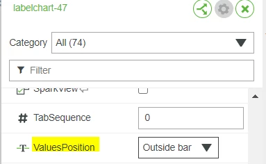

can we display bar values on each bar in Bar chart/Label  chart . should be responsive. please see below snap.

Hi @VaibhavShinde
Your property value: ValuesPosition should be set to Outside Bar in Label Chart as in below screenshot:

Hi @VaibhavShinde
The feature for adding values to the top of bars or markers in Line and Bar Charts was added in ThingWorx 9.0.
You will not see this feature for 8.5.x OOTB Chart Widgets. Also, per the internal discussions it does not appear there are any plans to update the earlier supported releases with this feature.

Hi @suverma ,
Currently i am using Thingworx 9.1 , I haven't used 8.5.x version. Is it possible to achieve this in TWX 9.1?
Feb 24, 2021 11:25 AM UTC
hi @VaibhavShinde
Yes you will be able to use it in 9.1 as well. So in my previous comment I meant, the feature for adding values to the top of bars or markers in Line and Bar Charts was introduced from ThingWorx 9.0 and is available for upcoming release after it.
