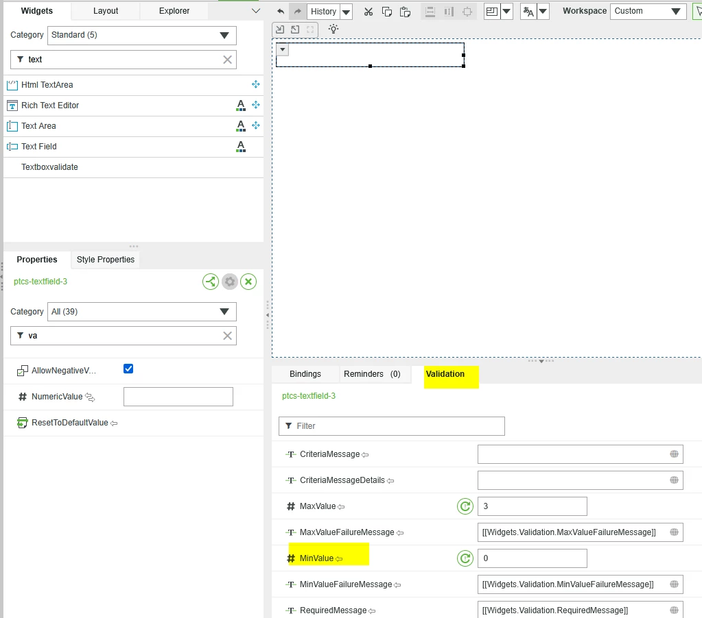

We recently converted a mashup to the latest version of ThingWorx 10.1.1.  During this conversion, our numeric entry widgets were converted to pctstextfield widgets.  The NumericInputMode was marked on each of these.  How do you set the MinValue and MinValueFailureMessage?  I’m not seeing these properties on the properties panel so I don’t know how to adjust these values.  Our text field is displaying 1 is the minimum value message and I want to get rid of this message.

yeah, the Validation hides from one if you never used it before :D
You find it at the “Validation”-tab at the bottom:

This is exactly what I needed.  Thank you so much for your help!!
