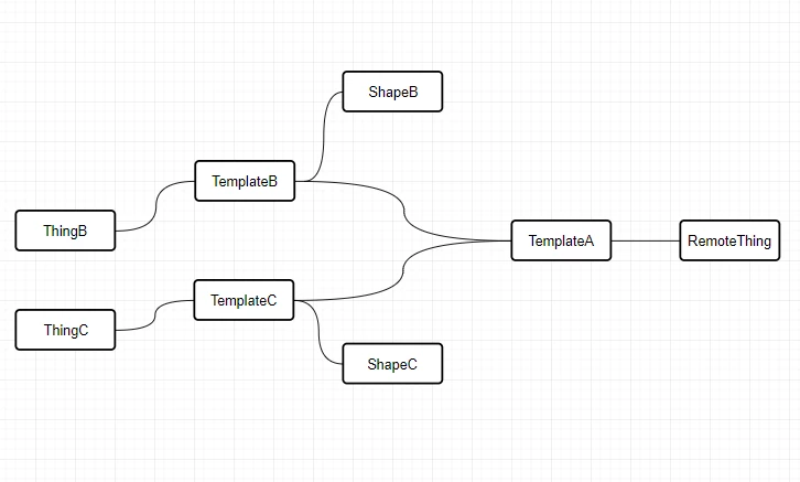

Now, here is my issue. We had to change the architecture of the shapes/templates.
The list can now display properties from shape B or C. It is only defined at "runtime" (based on user selection on another list).
Which means I have to call dynamic QueryNamedPropertyHistory on TemplateA level. But this doesn't work with Time Series Chart widget like it would when I would called it directly "at the shape level containing the properties".

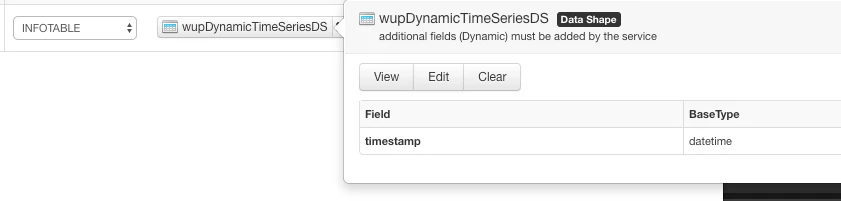

You can bind an infotable without column format (you can set a DataShape with only one column = timestamp for the X) on a Timeseries and should work like grid widget "ShowAllColumns". DataShape like:
And set the desired "NumberOfSeries".

You only need to assign the timestamp field for the X field, don't select nothing for the Y, as it are dynamic.
