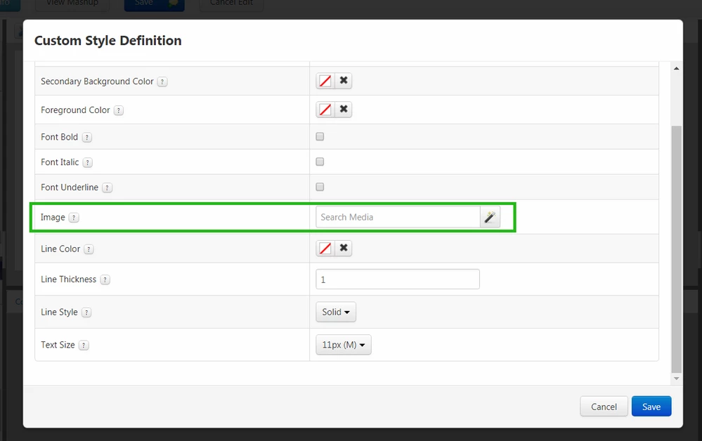

But when you already here, do you maybe know how to set images for buttons? Currently I can only set the text right? I would like to have the buttons look like arrows, but I saw the image widgets are missing click events.

June 19, 2018
In the button widget you can put images in the style property, if you want to show just the arrows let everything else transparent and without labor:
