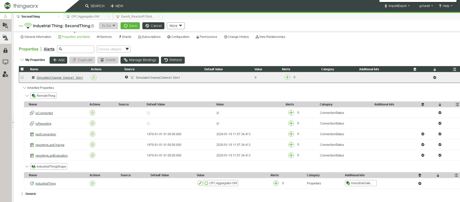

I successfully connected my OPC Aggregator (1.4.66) to Thingworx (8.5.0-b12). I made an Industrial Thing that can be used. Unfortunately, when I try to copy a property in order to have it with another name, The property is not connected, despite of the fact that the path / tag name did not change.
When I try to create another thing (from the industrial connection using the discover page), the thing shows me that it is connected but the properties are not connected.
Does somebody know why?
I get the following error:
nable to dispatch [ uri = /Things/OPC Aggregator-GW2/Services/BulkLog/]: Entity OPC Aggregator-GW2 does not exist or is not yet associated with a Thing
error executing APIRequest Message: Entity OPC Aggregator-GW2 does not exist or is not yet associated with a Thing, sending ERROR ResponseMessage to caller!
