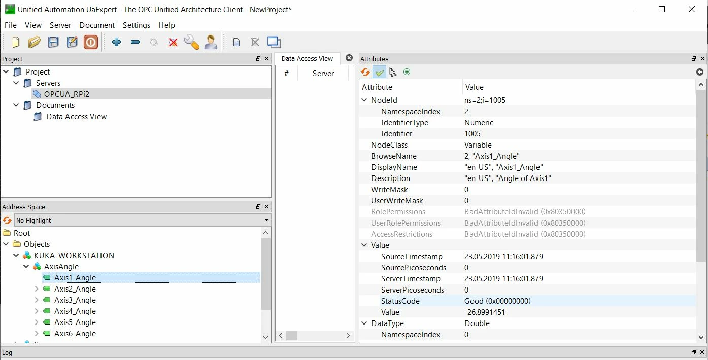

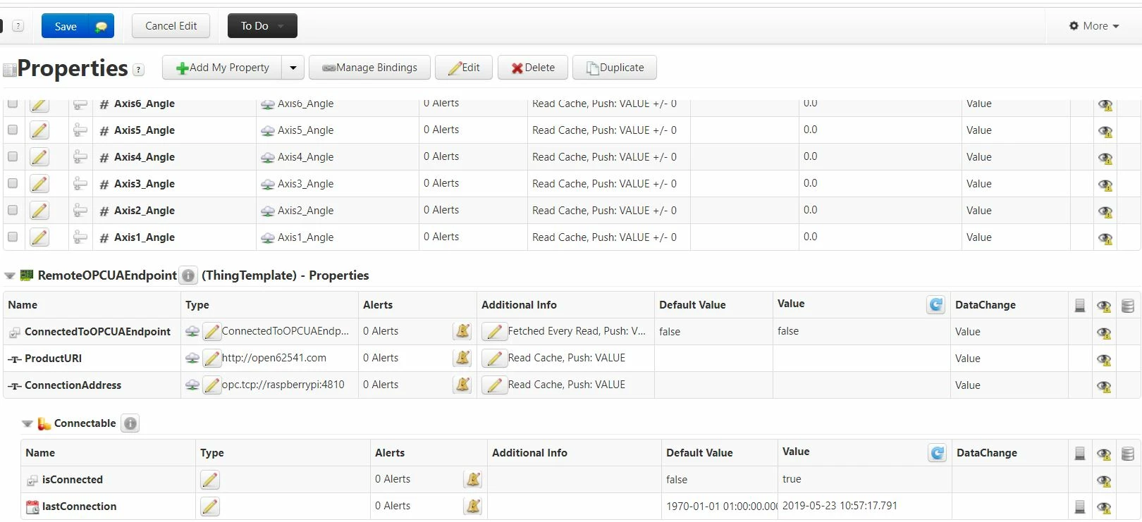

I tried connecting a OPC server to Thingworx using this guide and it already shows "connected: true" in Thingworx. I`m also able to bind the variables with "manage bindings", but the values are not transmitted (all are 0). On the server side the session is activated for a second but then goes over into a endless loop of "Closed by server":

I also attached a screenshot of UA Expert that shows the values that I want to read.
