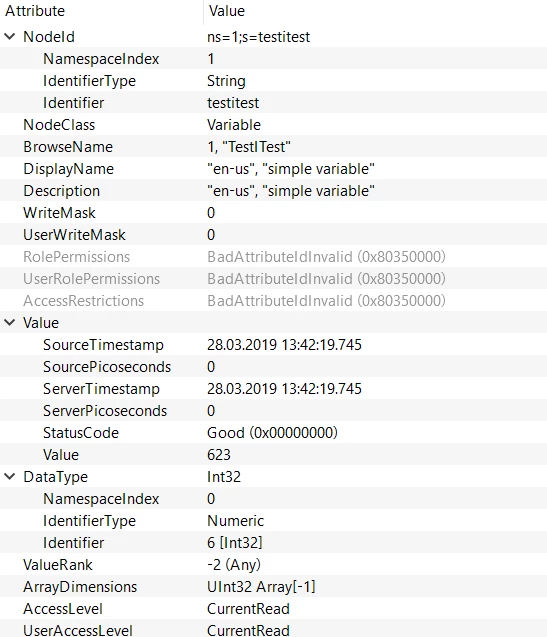

I can see the value with UA Expert after inputting the opc URL.

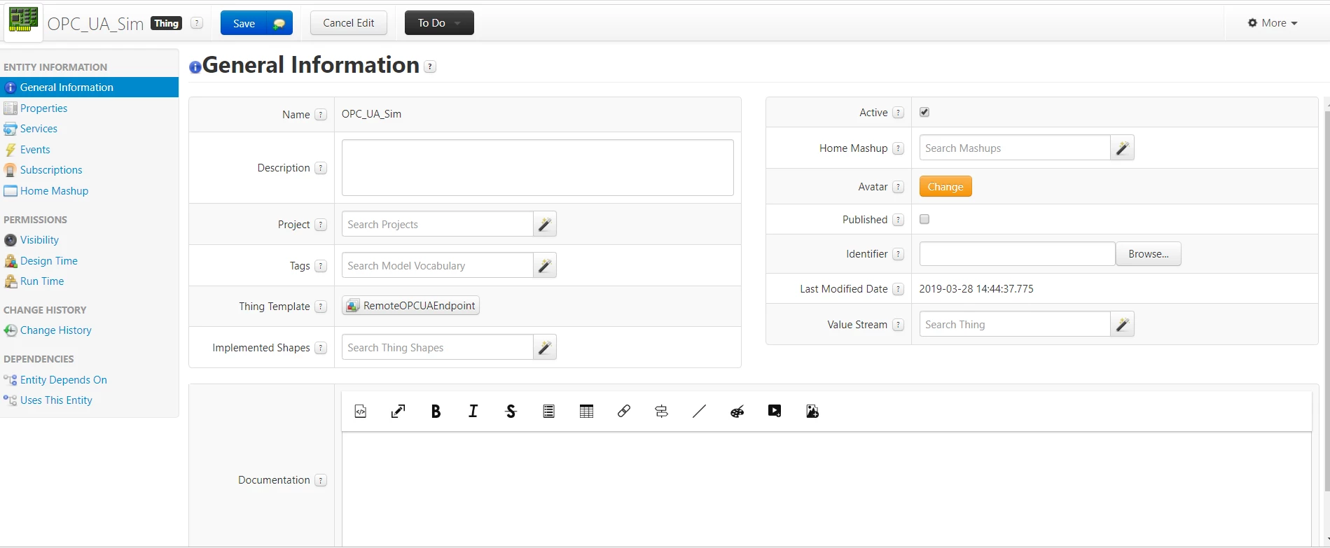

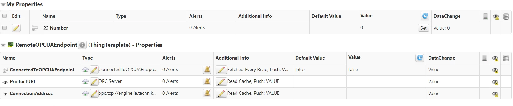

Heres my OPC UA Remote Thing configuration: (Picture attached)
All I changed was the ConnectionAdress, the productURI (is there a specific value I have to add?) and I added a property Number, that I want to read the value with. However it doesn`t connect and I can not see the number.
Is there anything else I have to configure or did I do something wrong?

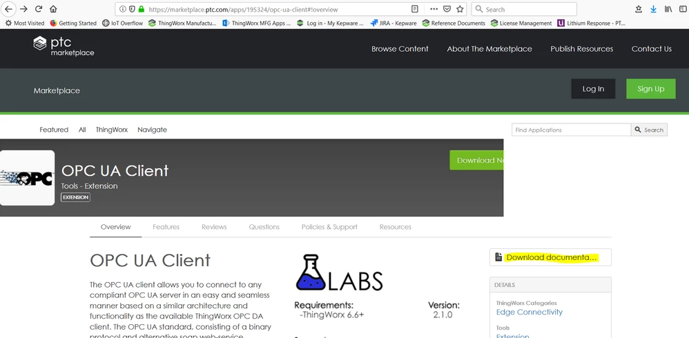

Did you install the .jar and config.json on the client side (OPC server)?  You may need to check the parameters in the config.json file.  You can find more information on this in the documentation available for this extension on the marketplace.

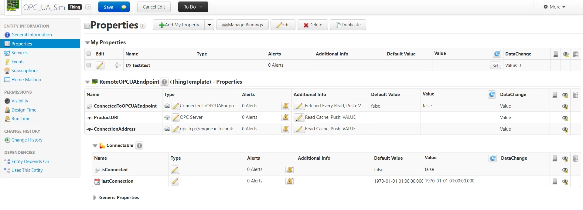

I used the OPCUAEndpoint template for my Thing and I changed the ConnectionAdress to my opc server adress as well as added an integer property that I want to be changed by the number the server is publishing every second. How would I configure the integer property so that it reads the value?
It seems that the server is not connecting.
I attached two pictures of my thing configuration.
