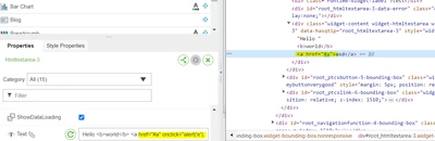

I understand your usecase but can only provide some insights from my  failed tests:
The Html-widget seems to remove the onclick attribute in my tests:
Hello <b>world</b> <a href="#a" onclick="alert('e');">asd</a>
My idea was to add a button (or link-widget) which will trigger the navigate function. And trigger a click on this button via the onclick of the html link via
onclick="document.getElementsByClassName('myButtonTriggeringNavigateOnclick')[0].getElementsByTagName('ptcs-button')[0].click();
Which does work in F12-DevTools console.
I did not find a direct js call to call the navigate function. But as we cannot execute custom js onclick it's not worth investigating to find a direct function,
