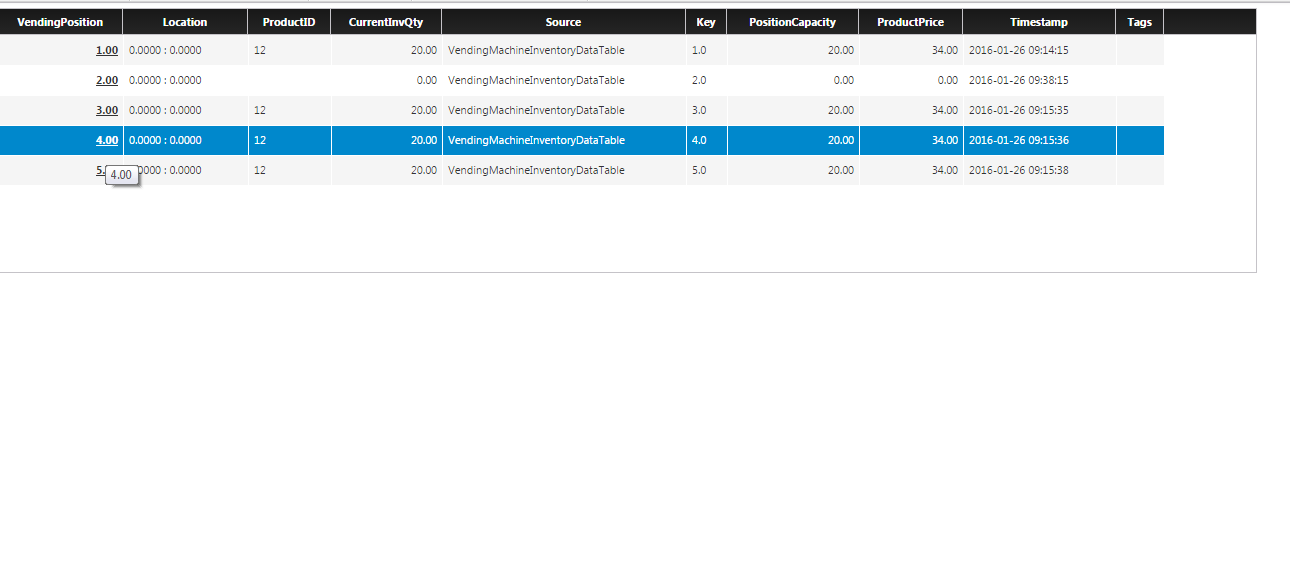

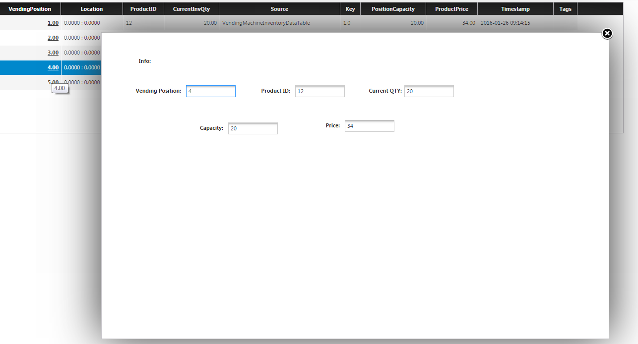

    May 17, 2016 7:34 PM UTC
    It is possible. same as Pai Chung said, I gave selected row "vending position" as input parameter to nav widget.1.png2.png
