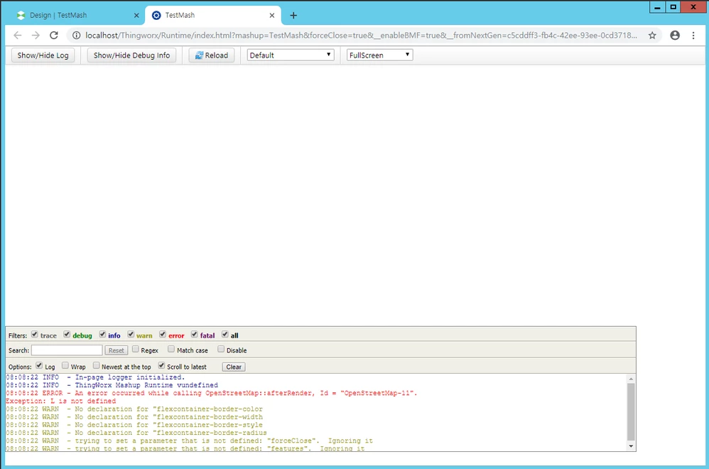

I am using Thingworx 8.5.
I'm trying to use the OpenStreetMap extension and I'm getting an error and hope it helps.
There was no error in Thingworx 8.4, but it occurs in Thingworx 8.5.
Please give me a solution.

I am the author of this widget, i have no idea why it has been removed on Market Place.
Please use the attach one for TWX8.5.

@jkim-10-11-12-12  The OpenStreetMap widget was available through the Marketplace, correct? If so, a number of unsupported widgets have been removed but are still available for download under MyApps, if they exist there. Please confirm if this is the scenario.
Also, I just checked, we already have JIRA created for this issue for R&D investigation.

The OpenStreetMap widget is in my Apps.
I want to use this widget in my project.
