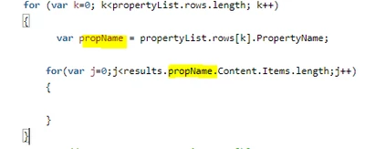

In the above screenshot i am getting value for propName in line 2 , but while using same value in (nested loop) line 3 getting issue as "org.mozilla.javascript.UniqueTag@5c998613: NOT_FOUND".
But while using actual value instead of propName in line no 3, its working fine.
Please let me know if any issue is there in code. Thanks in advance.

@SM_10230689 ,
Try:
results[propName].Content.Items.length;
Right now your code is looking for a property called "propName" on your results object... to use the value that you've assigned to propName, it needs to be in square brackets.
-Nick
