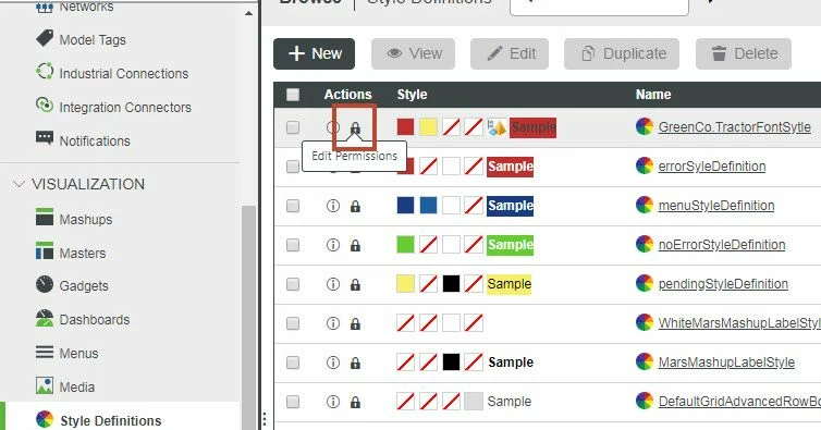

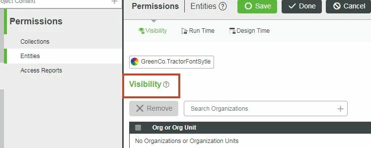

Does the organization have the permission/visibility on that style?
Visualization>Style Definition>xxx styler>Edit Permissions:

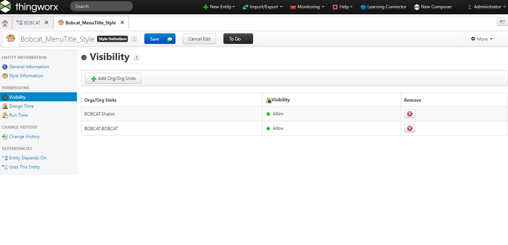

Hi  StevenChen,
I have given the visibility to style, but still am facing the same error.
