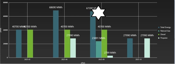

Overlay images on chart.
Is it possible to display some kind of figures/points on a line chart to mark end of a deadline.

Hi odukiya,
what we want to have is something as shown in the image below. We have to have an star or any other shape over some of the bars. The shape in this case indicates a time which is going to have some special time interval marked for an special event.

Hi @Vimal_Rawat.
Are you looking for something freeform that would allow you to place it in a desired place on the chart?  There isn't a way to do this.  You can change colors on a given set of values but there isn't an option for an image.
 If you're interested, you can post a request for this on the ThingWorx Ideas forum.
