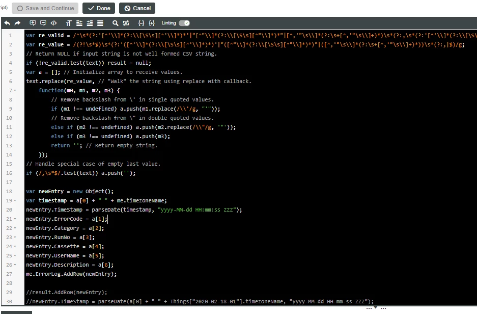

The parseDate function works when I run it in a service for testing purposes, but it does not work when I try to use it in a subscription that calls a service that uses the parseDate function.
Please see below:

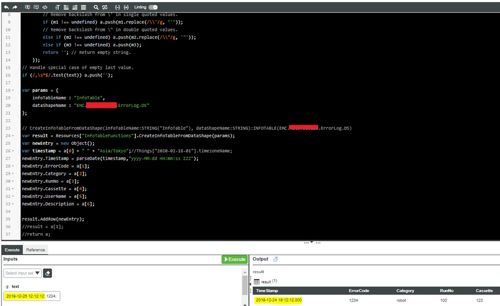

Working example: Converts PST time to JST time
Not working: Service called by subscription

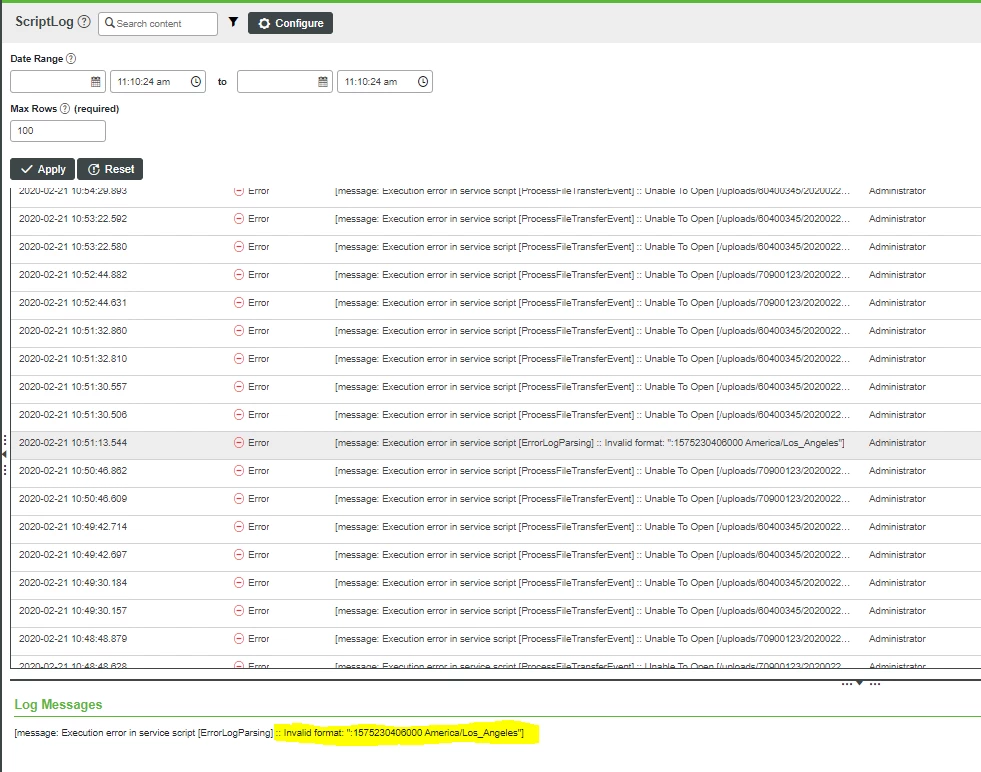

Error: "Invalid format"

I found the error....
It seems that I was using "eventData" instead of "eventData.newValue.value" as the input in the subscription....
The subscription is triggered based on DataChange.
