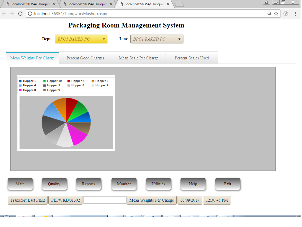

I want to Pass Parameters from Webpage to Thingworx Mashup.  To Explain In detail
I have a webpage designed by ASP.NET here i am integrating Thingworx Mashup in Iframe control.
So my Webpage have Asp.control and Thingworx mashup.
In below screen i have integrated Thingworx mash up in iframe. rest all controls are asp.net controls
When i select drop down (Asp.net Control ) the selected value of drop down should pass to thingworx mashup. and mashup should respond accordingly.
The received values from Asp.net webpages i should use in Thingworx Mashup.
I need to know the process how we can pass values from Asp.net web page thingworx Mashup.

Can you please look into my actual requirement.  If i pass parameter to Thingworx Mashup from ASP.NET webpage.
like in above screen if i pass drop down selected value ("BPC1 BAKED PC") to mashup pf thingworx like this

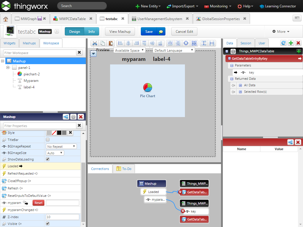

I have Done Following Steps for above my use case
1) I have created Mashup parameter named it as "myparam"
2) I have Created a Service in Thingworx Mashup "GetDataTableEntryByKey" and giving input as Mashup parameter (myparam)
I bound my service by accepting input as Masup parameter(myparam) --->Key
3) I am calling My Mash up in iframe like this
<iframe id="if1" width="700" height="560" style="visibility:visible" src="http://localhost:8080/Thingworx/Mashups/testabc? appKey=0f4b4662-7d09-46c3-a766-bbbcfa73ad99&x-thingworx-session=true&myparam=1">
   </iframe>
In the above URL.
testabc--Mashup Name
myparam--Mashup Parameter (value is '1')

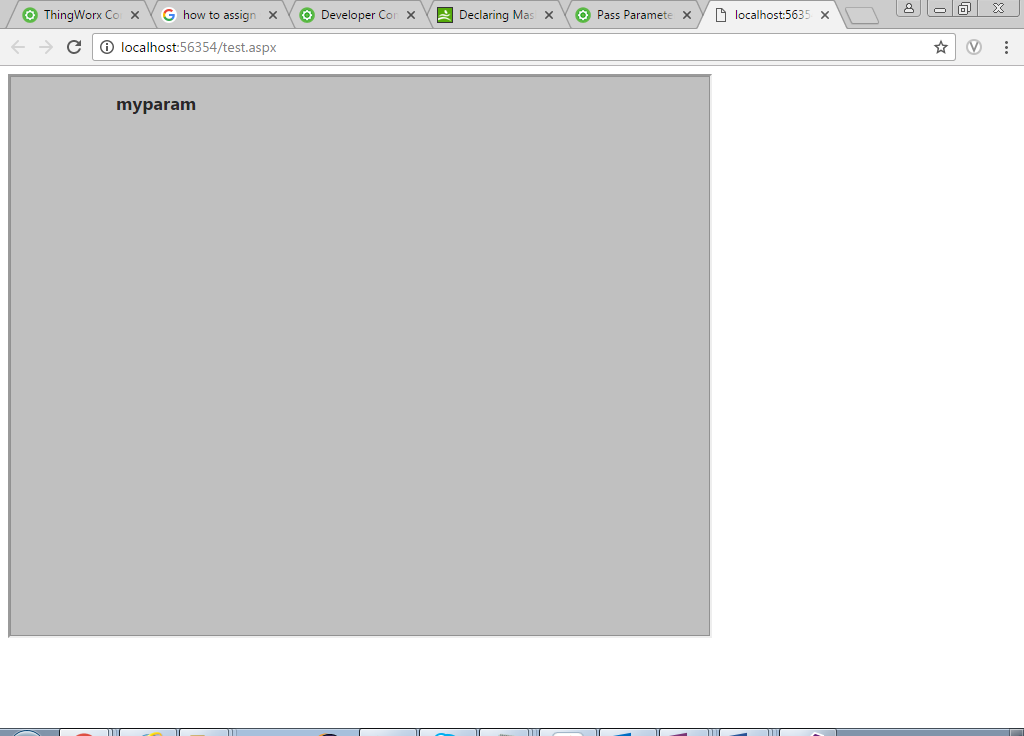

The web page looks like this
So  Here I need Some Clarification and Help.
in above Mashup myparm (mashup parameter) there is no input binding. The Output of myparm is input of service.

1) How to assign value which i am passing in URL to mashup parameter.
2) Is there any other way to use "Session parameter" to get this approach.

&myparam=1 is how the value is assigned to the parameter. you can try binding the myparam from the mashup to a Value display on the mashup to check.
then The service itself should run based on myparamvaluechanged event which comes with the mashup parameter
I don't see a need to write to the session, if you needed to do that though you would wire from the mashup param to the session or use a service to set it server side.
