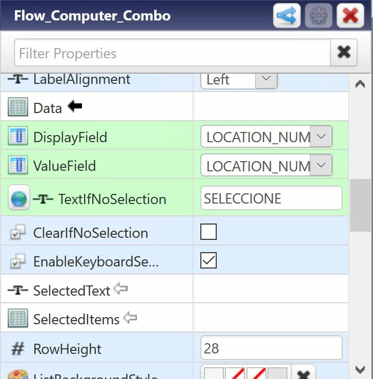

Hi Guys,
I am loading a drop down list with string values bring from my database, but I need pass that value chosen to one specific thing property,  i don't know the way to do this.

The selected value comes from the Data Source the right side pane not the Widget.
You assign Data to the widget and then from that same Data Source the Selected Row(s) tracks what is selected in that widget. So you drag it from that right side onto whatever you need to pass the selected value to.

Selected Values are tracked in the source. So in the Data pane, where you have brought in the service, you'll see Result/Data and Selected Row(s) /Data
the Selected part represents the selection in any widget that you have bound the data to.
So you'll take selected row(s)/PropertyName and drag and drop that onto what you need to bind it to, either an input parameter to a service which will then apply that value to the model (a Thing property for example) or onto a Widget.

yeah, I know
But in my case this widget don't have the option to drag the select value to the property, only get Data, it's normal?
