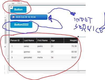

I have a test Mashup
when I click the butto marked in red I got the results form db, this works fine
Now I need to get the datetime when I clicked the button222 (marked in blue) and pass this datetime to a service

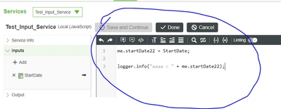

I also made a generic service that gets an input parameter and log the data
I tested the generic service alone and works
But I cannot bind what I need from the mashup to the service or I dont know how to do it,...
How can I bind the click event to get the datetime from the datetime widget and execute the service with this value as an input parameter?

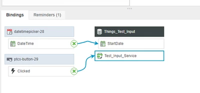

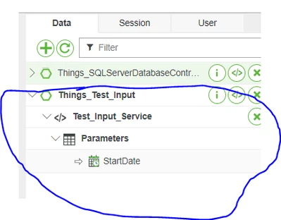

I  believe I just did it....
something like this
Is that correct?

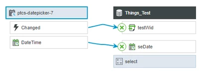

You can bind date selected value to service as input and date changed event to call the service. whenever date selection in the date picker changes, it will trigger your service.
