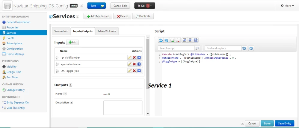

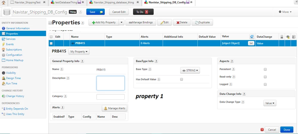

How can I pass a result to a property of a Thing?
I have a service which executes the stored procedure and returns a output string. I am calling this stored procedure through a subscription so whenever there is a data change in a tag in kepware, a row is updated into the sql.
I wanted to set the service output string in the property of that Thing through a subscription whenever the tag value is changed.
PropertyPropertyserviceservicesubscriptionsubscription

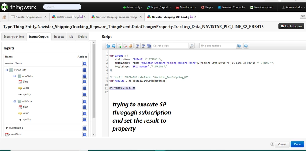

Hi @svisveswaraiya_285988 ,
have you defined the output of your service? I am not familiar with the old Thingworx layout but the question marks do not tell me the output type.
Additionally from what I know the service output needs to be stored to the variable result in your service. But I am also not familiar with this Execute syntax you use there.
You are trying to map an infotable (output from service) to a string (property on Thing). To map your an entry from the first row, you result1.<ColumName> or choose your row with result[rowNumber].<ColumnName>: E.g result1[3].name

Hi @kornelius,
Thanks for your response. Should I change the property base type to infotable? Because after changing the subscription in a format you told its not setting any value in property.
var params = {
stationName: undefined /* STRING */,
skidNumber: undefined /* STRING */,
ToggleType: undefined /* STRING */
// result: INFOTABLE dataShape: "Navistar_ExecShipping_DS"
var result1 = me.Exec_TrackingData(params);
me.PRB415 = result1.ReturnResult
The ReturnResult is the column name of my infotable of Exec_TrackingData service.
Please tell me what I am missing.
The property base type in the PRB415 should stay as a string. In general it looks fine. As you are still facing issues, I recommend following:
To understand how to update properties, strip away the complexity first before working with a subscription:
1) Create an infotable with one row (e.g. as property, or in a service)
2) Write one field from the infotable into a string property on a thing (with a service)
Use the script logs to understand where your service fails.
Then apply it to your case.
