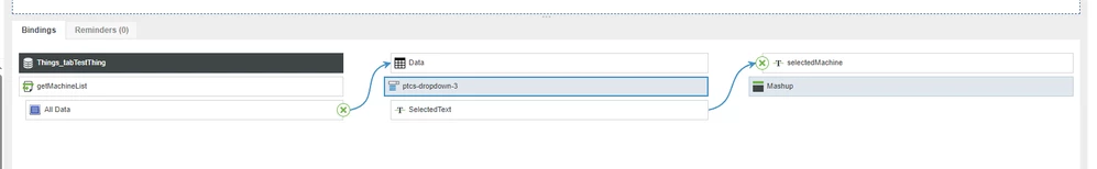

You have to create a Mashup Parameter in all 4 Mashups. And pass the selected value from Tab 1 to its Mashup Parameter
Bindings in Mashup 1

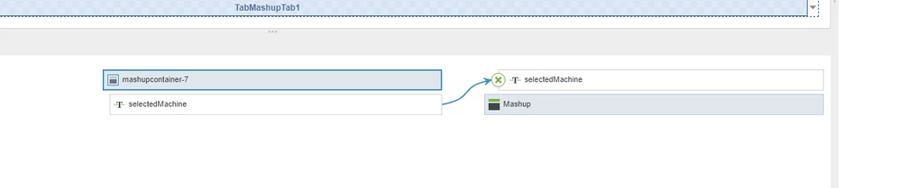

In the main Mashup, pass the value from Tab1 to the main Mashup Parameter

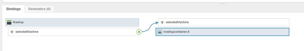

From the main mashup, pass the value to the remaining tabs contained mashup

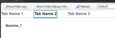

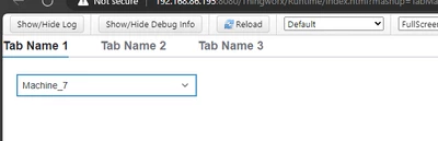

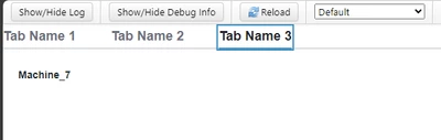

The result should look like this
