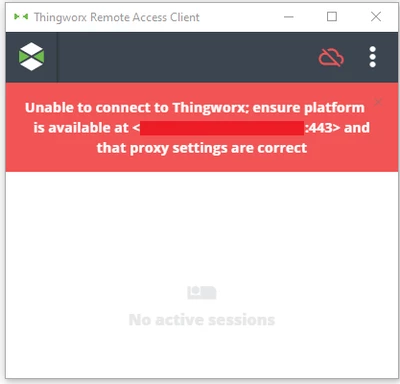

My szenario: I have a device where EMS running on. The remote device is connected to TWX. With my admin user (in group Administators) I can established a tunneling connection with the device (for example ssh) and every works fine. Now when I try this with a normal user (no in Administators group) the connection failed immediately after the Thingworx Remote Access Client is started:

Unable to dispatch [ uri = /Things/tw-ra-client-1c90fe81-90c0-4f00-82dc-e8ce00aa4593/Services/EnableThing/]: Unable to Invoke Service EnableThing on tw-ra-client-1c90fe81-90c0-4f00-82dc-e8ce00aa4593 : Not authorized for ServiceInvoke on EnableThing in tw-ra-client-1c90fe81-90c0-4f00-82dc-e8ce00aa4593
error executing APIRequest Message: Not authorized for ServiceInvoke on EnableThing in tw-ra-client-1c90fe81-90c0-4f00-82dc-e8ce00aa4593, sending ERROR ResponseMessage to caller!
Its looks like he create a thing names tw-ra-client-1c90fe81-90c0-4f00-82dc-e8ce00aa4593 but has not the permissions to call EnableThing.
The other logs looks normal.
