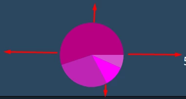

Pie Chart Expansion issue in Responsive Dashboard
Whatever I do, the pie chart doesn't expand, in Responsive Mashup
It Expands well as per the width and height in the Static Mashup, but it doesn't expand in Responsive Mashup.

hi @slangley ,
Thanks for the quick reply, I got the solution, so PIE CHART expansion depends on the Height of the pie chart. The higher the height, the more it expands.
This point I was missing and Increasing the width and testing, which was the wrong way of doing it.

Hi @pshashipreetham.
What version of ThingWorx are you running?  Which widget are you using?  We tested under 9.3.7 and it appears to be working as expected.

hi @slangley ,
