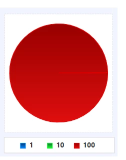

January 12, 2023
I tested in both a 9.1 platform and 9.3.4 with adding a pie chart and couldn't replicate;
9.1;
9.3.4;
I did have to make the container static to make the pie chart this "small" though. But even with it as responsive the legend stayed this size and only grew in width.
I have attached the things I used for my test in case you want to check it out.

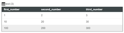

Values I used in my infotable;
Not sure if this is helpful at all, but hope you can get something out of it.
