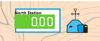

Hello.
I have a layout, and I want to insert a shape in it with a value display in the center. But once I put the shape, there's no way for me to put the value display on the same layout. Any solutions for this?
Thanks!

Hello @Radu ,
Let me see if I understand your request. You have a row which you want to display a shape, and in the middle of the shape you want to have a value display. It this what it might look like:
In this case it is an Image with a hole which has been placed so that the value display can be seen. Is this a possible solution?

Hi Radu,
Try to use Frame layout extension widget which is available in the PTC market place.
In that Frame 1 you can use shape widget and frame 2 you can use a value display widget.
Try the above. let me know if you got a solution.

Radu15-MoonstoneAuthor
August 26, 2019
Thank you for your insight! That is exactly what I had in mind and it works. A great extension.
