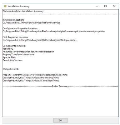

In the installation of the Platform Analytics, I configure the Analytics server integration, and all the installation steps run successfully as shown below:
Also, I followed all the steps to configure successfully the Property Transform Settings in ThingWorx, the RabbitMQ password encryption, and finally, I left by a defect the Property Transforms scalation.

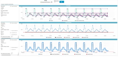

Using a dataset I emulated a remote device with a Pressure signal.
I used a timer to stream the pressure signal each 1, 10, 50, and 100 ms.
The pressure signal has the following form:
I created three property transformations from the original pressure signal and all worked as expected:

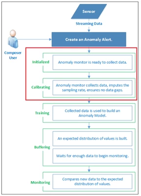

I configured an anomaly called PressureAnomaly, with the following parametrization:
I did four tests transmitting the data at 1, 10, 50, and 100 ms separately, and the alert cannot complete all the steps outlined in the following diagram. All the times I tested the process only reach the calibrating state.
I followed carefully all the steps that were described in the Thingworx documentation but all the processes finished in the seme calibrating state.

Aug 26, 2021 7:22 PM UTC
@sarjasalc ,
Something of note, the AD with Property Transform intergration functionality was designed only for use in a Active-Active ThingWorx Cluster setup. Can you confirm if you are in a ThingWorx Cluster?
The integration you speak of is only for use in this infrastructure scenario, though since AD is working without cluster setup I believe this is not your use case. Details can be found here: https://support.ptc.com/help/thingworx/analytics/r9/en/index.html#page/analytics/analytics_install/anomaly_detection_architecture_cluster.html
