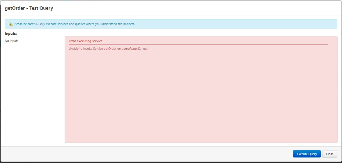

     I have installed SQL server 2016 and SQL management studio 2017. I am facing an issue while connecting sql to thingworx. The configuration details in thingworx are already filled.
Below are the JDBC settings:
JDBC Driver Class Name : com.microsoft.sqlserver.jdbc.SQLServerDriver
JDBC Connection String :jdbc:sqlserver://localhost;databaseName=thingworx
Below is the error i received when i connect to database.
Jan 29, 2019 9:52 AM UTC
you probably missing valid credentials configurations over entity
check jdbc connection URL as well
it should be like :(missing port 1433 in your URL)
jdbc:sqlserver://localhost:1433;databaseName=thingworx;applicationName=Thingworx;
