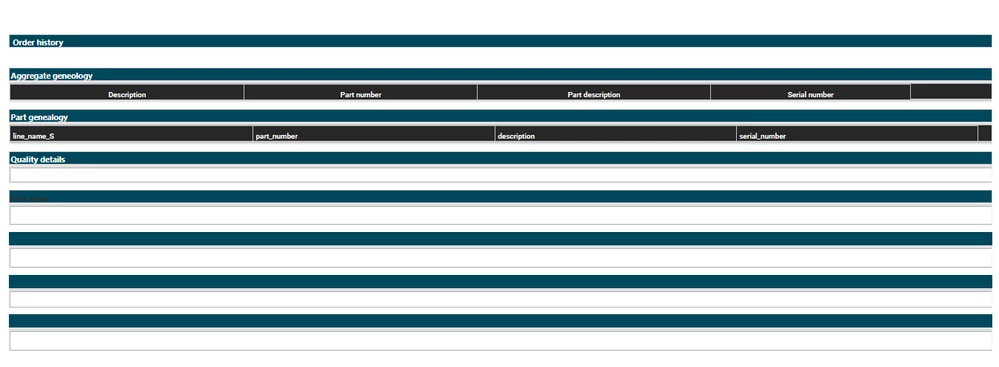

I have an requirement where i need to display multiple grid( total grid 9) on same mashup with vertical  layout. while I did this, I got grid in very small / compressed in size ,so data inside that is not displayed properly.
Is there any way to increased mashup size or add scroll bar to layout / mashup ?
Or any other possible solution for this ?

 Does your girds not have anything in common? for example are they not generated from the same Things' Information? If they are, I would say a collection widget would still be the best option.
Another option would be to use a static mashup and define the size accordingly.

Do all the grids need to be visible at the same time?
January 31, 2019
yes. All the grids must be visible at the same time.
January 31, 2019
The best way to fit all 9 grids in neatly would be to use the collection widget.
