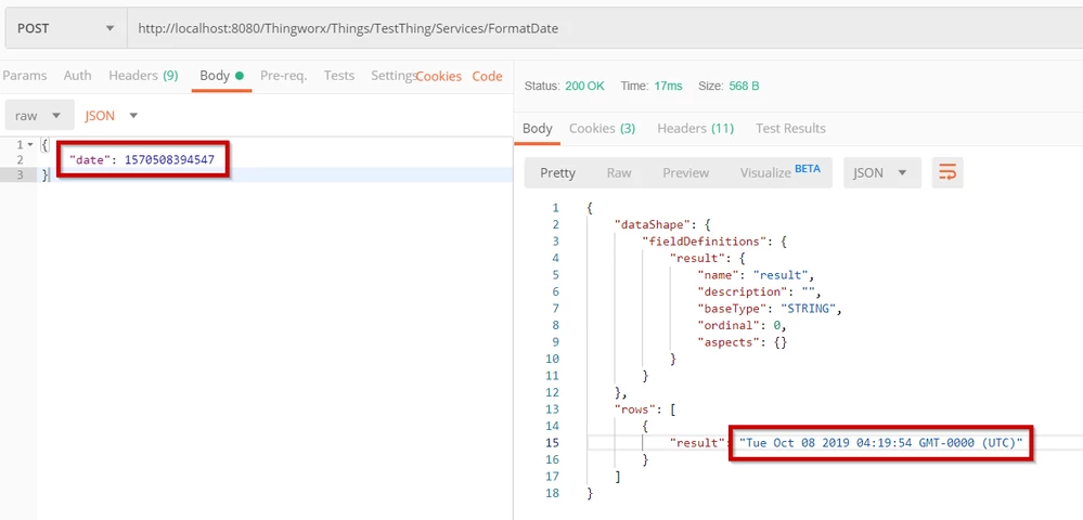

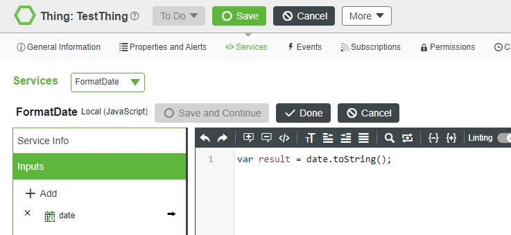

Thanks for you answer, that has helped a lot. I still can't get my input values to work though.. They are defined as DATETIME inputs. I've tried entering them under the "YYYY-MM-DD HH-mm-ss-SSS" format as well as under a DATE format, and a Date.getTime() format, but so far that does not seem to be working.
What format should I be using when sending the inputs in for my POST request?
Thanks!
18-Opal
October 8, 2019
Just pass it as a number:
/ Constantine
