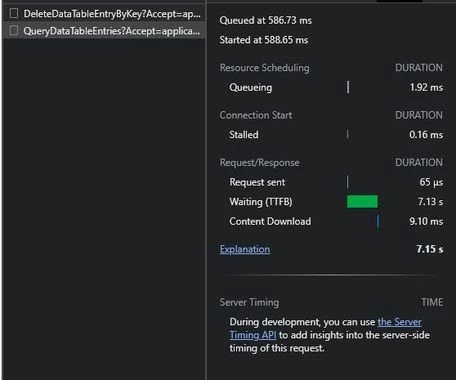

Querying database and value stream taking long time to respond.
Below is the example of querying database that co0ntains 62 entries. Taking 7.13s to respond.
The server was working fine 2 days ago. Within milliseconds services were responding.
Because of delay in querying all the services throwing timeout error and failed error.
Following steps are already considered:
  1. Disabled a scheduler that was queueing up threads (Created 10 days ago)
  2. Restarted ThingWorx foundation and database
  3. Application logs does not have any data related to it.
  4. There were no code changes done in past 5 days
  5. Script Timeout increased to 3600s
  6. CPU , Disk and Memory status looks fine

ThingWorx Composer loads as earlier. Please help me with this issue.
