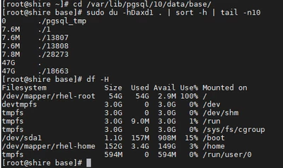

Hello. I installed ThingWorxFoundationPostgres-8.5.8-x86_64.run on RHEL. It was working fine and I stopped using it for a while. When I wanted to enter again, the empty Composer appeared and I could not navigate. I saw that the disk was full and I deleted some archived logs, then I restarted tomcat and RHEL server, with which afterwards I could not enter the Composer again. I cannot start the Postgres server. Can anybody help me?

anaclos14-AlexandriteAuthor
Feb 26, 2021 2:32 PM UTC
Hi, @slangley The problem is that I have a full disk and can't start postgresql. I am sending you a capture of the disk usage where it can be seen that the postgresql base folder is taking up the most space. I don't know if the database can be exported to another instance to reduce its size and then import it again.
Support
Feb 26, 2021 2:47 PM UTC
Hi @anaclos.
You might review this page from the PostgreSQL web site.  If you decide to run the utility, I recommend creating a server backup first.  You may run into issues running the utility if the space is fully depleted on disk.
