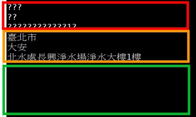

Hello, recently I use PostMultipart, and these's chinese character in my partsToSend
so I set the headers like this:
var params = {
proxyScheme: undefined /* STRING */,
headers: {"Content-type":"multipart/form-data; charset=UTF-8"} /* JSON */,
ignoreSSLErrors: undefined /* BOOLEAN */,
useNTLM: undefined /* BOOLEAN */,
partsToSend: formData /* INFOTABLE */,
workstation: undefined /* STRING */,
useProxy: undefined /* BOOLEAN */,
repository: undefined /* STRING */,
proxyHost: undefined /* STRING */,
url: url /* STRING */,
// result: JSON
var result = Resources["ContentLoaderFunctions"].PostMultipart(params);
Here I print out the content which api server received:
Red: If I remove the content of headers, every chinese character  will become to "?"
Orange: There's no problem as I use Postman to test the api
Green: the content which api server received will become to nothing as setting the headers
I also try to set headers: {"Content-type":"charset=Big5"} but the result is the same as UTF-8
anyone can help me?
thanks a lot!

Hi @RC_8716579
What version of ThingWorx are you running?  Can you provide more detail around your use case?  What are you sending it to?
Regards.
--Sharon
September 5, 2021
The version of Thingworx is 8.4.
In the detail, I write the RESTful API by golang and test it by postman, it seems work normally.
And I want Thingworx to get the data from the API by POST method.
Is it not ok to use form-data ?
