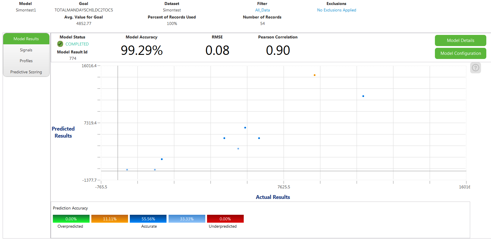

It uses a set of predictive analytic algorithms and machine learning techniques to identify meaningful patterns in the data. Based on this analysis of the existing data, a generalized prediction model is generated. This model can then be applied to subsequent data to make predictions associated with specific outcomes.

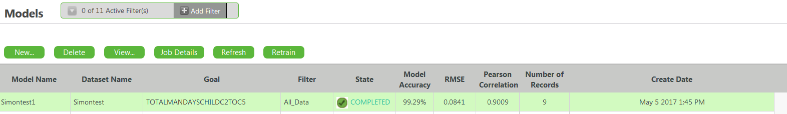

Generating a prediction model in Thingworx Analytics involves both training the model and validating it. Training is the process by which Thingworx Analytics uses a number of machine learning techniques (see the chart below) to construct a prediction model. The training process leverages 80% of the existing data to build a model and validates it against the other 20%. If the accuracy of the model can be improved, the process optimizes the model in different ways until it produces the model with the highest accuracy for predictions. At the end of the prediction model training process, Thingworx Analytics publishes a ready-for-use model that you can use to start making predictions.
How to Access Predictive Analysis Functionality via Thingworx Analytics:
Thingworx Analytics predictive model generating functionality can be accessed via the following methods:
REST API Service: Using a REST client, you can access the Prediction Model Generation Service which includes a series of API endpoints to submit training and validation requests, retrieve results, list jobs, and more. Requires installation of the Thingworx Analytics Server.
Analytics Builder: ​​As part of the Thingworx Analytics Extension, Analytics Builder provides a user interface for interacting with your data. In addition to loading and configuring a dataset in Analytics Builder, you can also generate a predictive model. Requires installation of both Thingworx Core and Thingworx Analytics Server.
