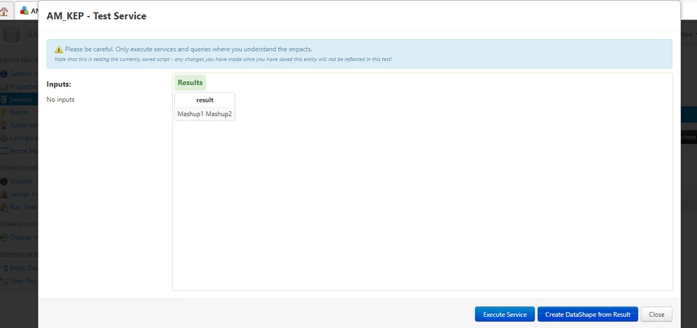

For that, you should use InfoTables and DataShapes.
7 replies
April 21, 2019
var result = "Mashup1" + '\n' + "Mashup2";
Or
var result = "Mashup1" + "\n" + "Mashup2";
Both should work.
April 21, 2019
Hi @ashaban,
Thanks for your swift reply. I tried both the script but it prints on the same line. Could you please tell me if there is any other way to achieve it?
April 21, 2019
The result should be used in a mashup.
Bind the result string to a Text Area widget.
