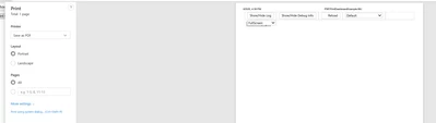

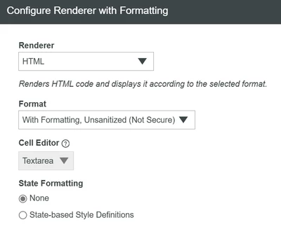

I followed the steps below to print the Dashboard...
  1. Create a thing and add the below piece of code to it and make the output string:
    result = "<button onclick='window.print();return false;'>Print this page</button>";​
  2. Then, go to the Mashup and add a Value Display widget.
  3. Bind the Service that was created in step 1
  4. Make the changes to the Render options of the Value Display Widget, as shown below:
  5. Once we press on the button/value display widget on the Dashboard, it open's up to a Printing options Pop-uppshashipreetham_1-1749121754656.pngpshashipreetham_2-1749121783063.png
