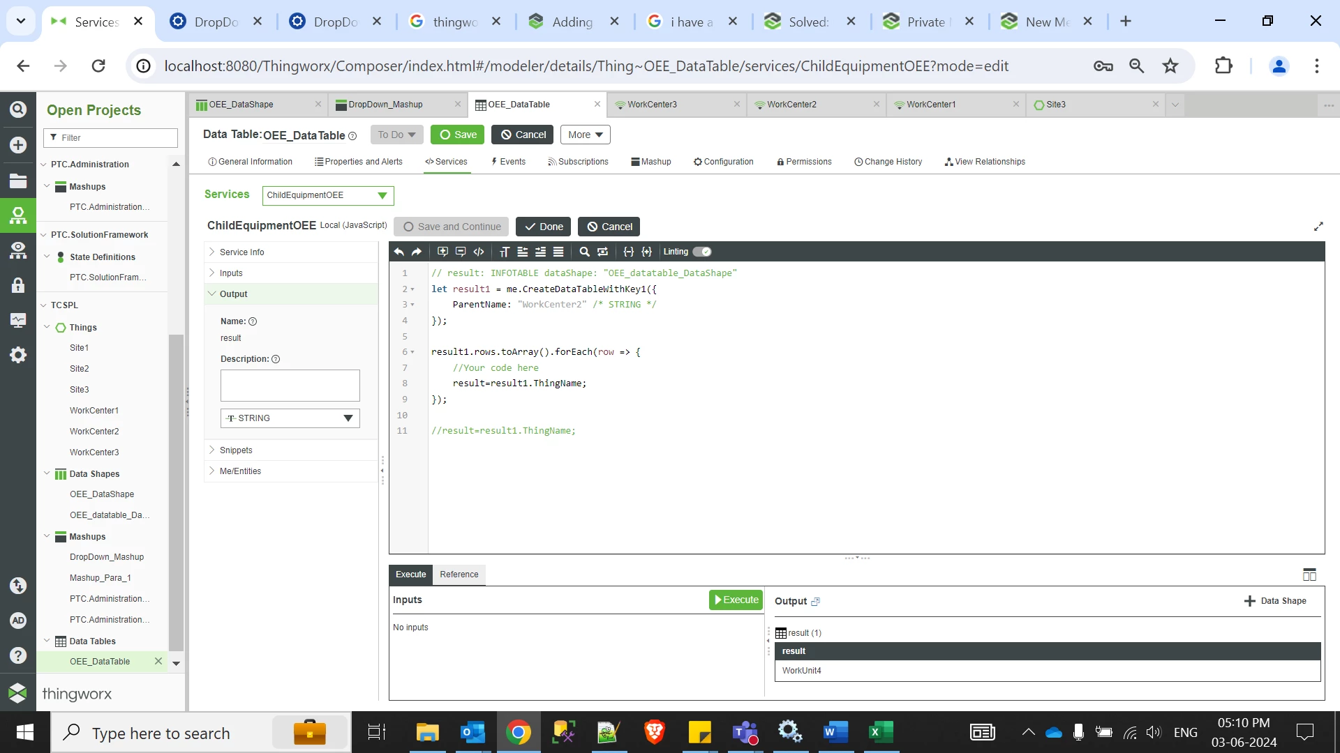

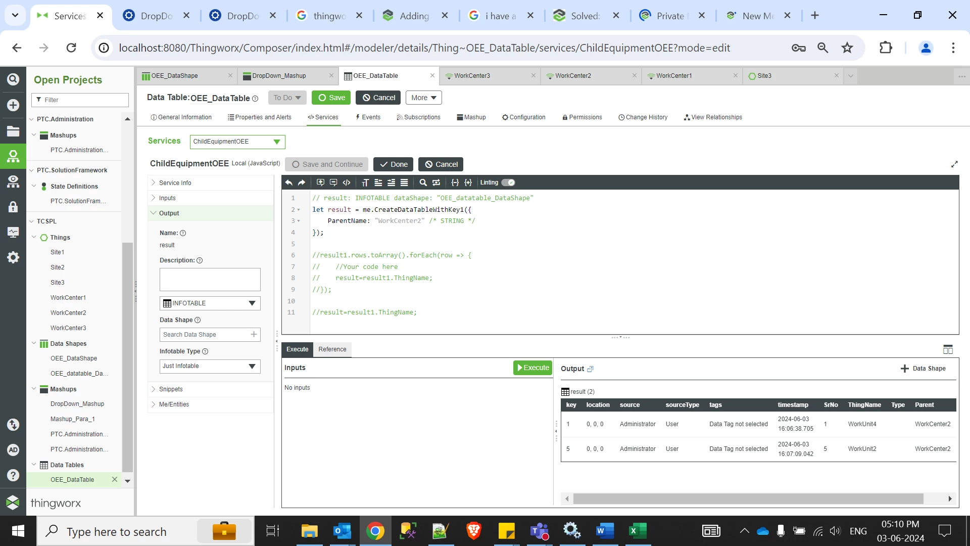

Hello All,
I have a service which takes a input in string (it is basically a parent equipment name) in the output I am getting an infotable I want to print all assets under that parent. I am to do that but only first equipment is getting printed.
PFA and also check data type I might be missing something

Hi @Pratik_Aswale
Based on Screenshot 27 you have what you are asking for, just with additional information.  Depending on what you mean by "print" you can display this in a grid and hide/exclude the extra columns.  Put this in a dropdown and use ThingName as display.
If you want the resulting infotable to only include ThingName then you will have to transform the info table into another table by creating a new info table ( I would recommend using OOTB DataShape, EntityList).  Look at the code snipits for info table on how to create, loop, and add entries.
Travis

Hi @Pratik_Aswale
If you want ThingName as a String
let thingNameArray = [];
result1.rows.toArray().forEach( row => {
 thingNameArray.push(row.ThingName);
// Convert array to string
let result = thingNameArray.join(",") // Seperate each thingname by comma
/VR

Thanks for the help but I need result in infotable
