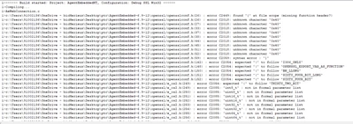

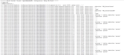

Hello, I'm trying to build the PTC Axeda Agent Embedded version 6.9 demo projects, but getting an error in files using openssl files, I tried using different versions of openssl since the documentation doesn't specify which version is compatible for embedded agents. I am getting different errors with different versions of openssl (0.9.8zg, 1.1.1s, 3.0.7). I am trying to build the projects in vs2008 to start before running them, but no success
