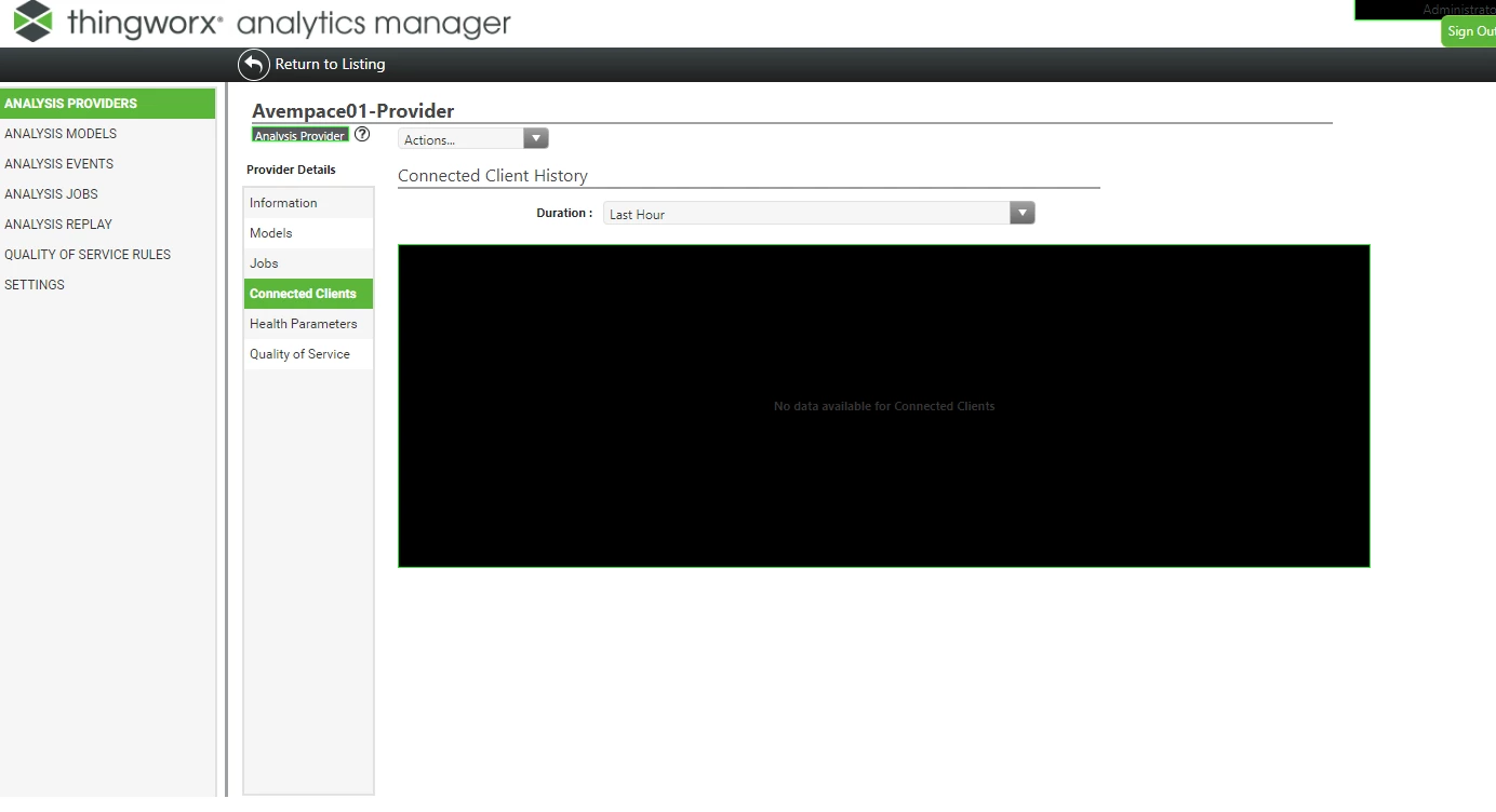

I am trying to deploy an analysis model and test it but i can't seem to get things working i keeep getting this error on the application console : [message: Thing [TW.AnalysisServices.AnalysisResourceProvider] is not running]
I tried to see if the provider is connected and it seems it is not since no clients are available (see attached image).
if anyone can provide help i would be grateful.

  • Can you provide which version of ThingWorx Analytics and ThingWorx Platform you are using?
  • Can you confirm that you have created an Analysis Provider in Analytics Manager, using the appropriate connector?
  • Are you able to provide the application.log file from you Platform Server?

Thank you for answering, as for your questions i am using thingworx Analytics 8.3.040507 along with the Thingworx platform 8.3.2-b535. and yes i did manage to create an analysis provider the proper way and i even was able to publish the models.
I joined the application.log file as you asked.

Hello, I am seeing multiple errors in your TWX Composer application log related to timers, and duplicate entities from your persistence provider for Composer.
Was your ThingWorx Composer upgraded from a previous version of ThingWorx Composer?
The two version numbers you reported are a match for each other, so there is no compatibility issue there. Can you also confirm if your ThingWorx Analytics Server is running, by running twas.sh status in /ThingWorxAnalyticsServer/bin ?
To confirm, when you created the Provider in Analytics Manager, did you use the TW.AnalysisServices.AnalyticsServer.AnalyticsServerConnector ?
