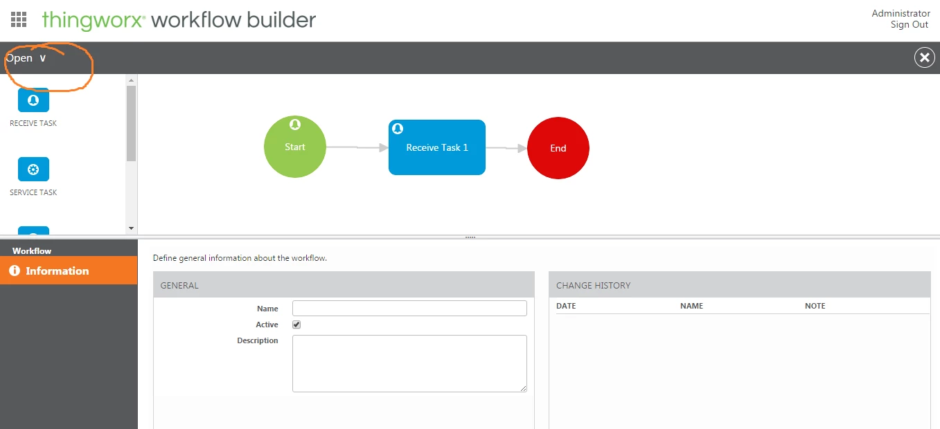

Problem in Thingworx utilities workflow
Hi,whenever i launch workflow i get a page with just open tab.New,Save tabs are not being displayed.How to solve this issue?
Mar 16, 2018 4:30 PM UTC
Check your user permissions.  The user needs to be in the PTC.BusinessProcessAdministrators user group to be able to create and edit workflow definitions in Workflow Builder.

Hi anglea,thank you for response.The permissions are correct but still i am facing the issue 😞 .

Another thing you could check is the 'Visibility Support for ThingWorx Utilities' section in the installation guide:
https://support.ptc.com/WCMS/files/174010/en/TWXUtilitiesInstallGuide.pdf
