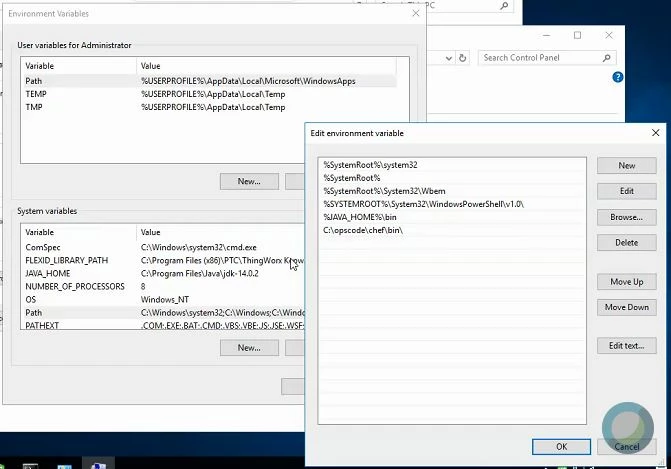

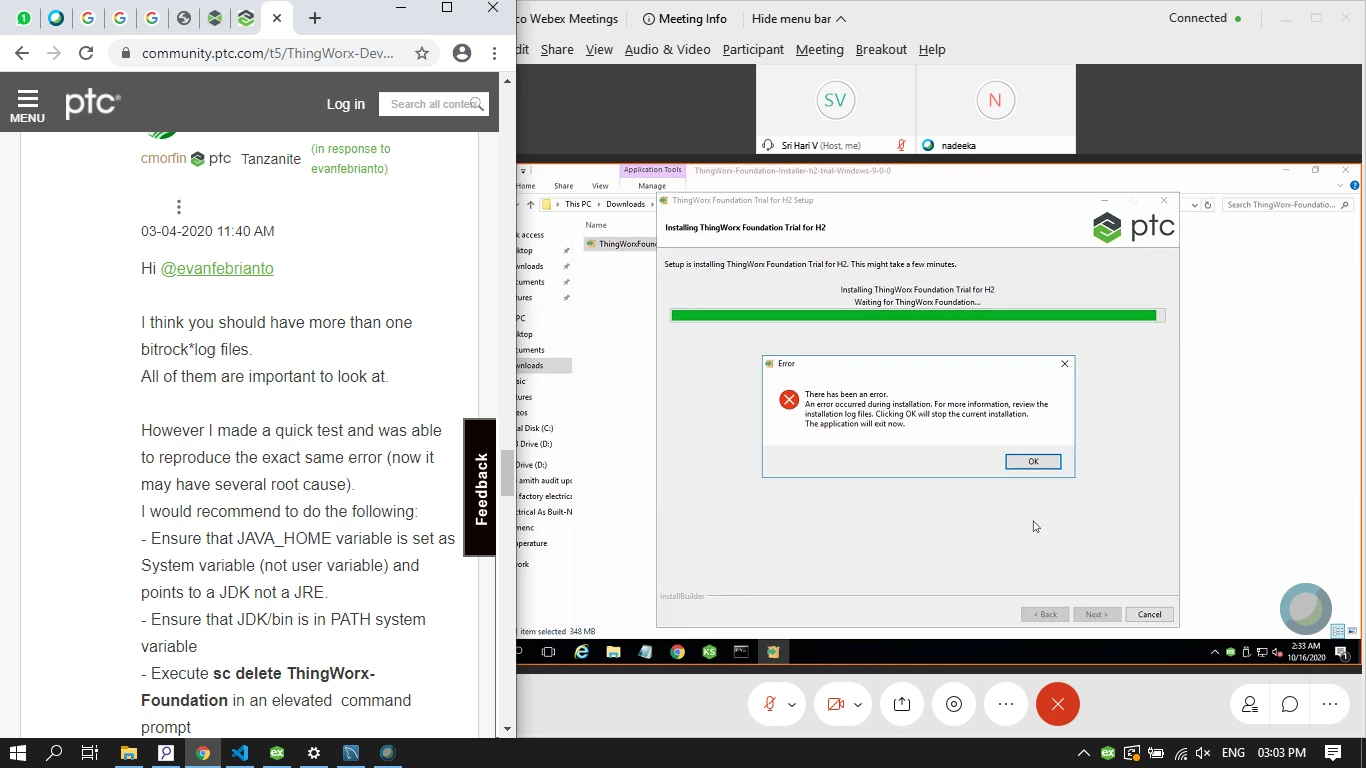

I am trying to install Thingworx Foundation Trial version. I have installed java JDK and set system variable. But I am still getting error. Please find the attached image.

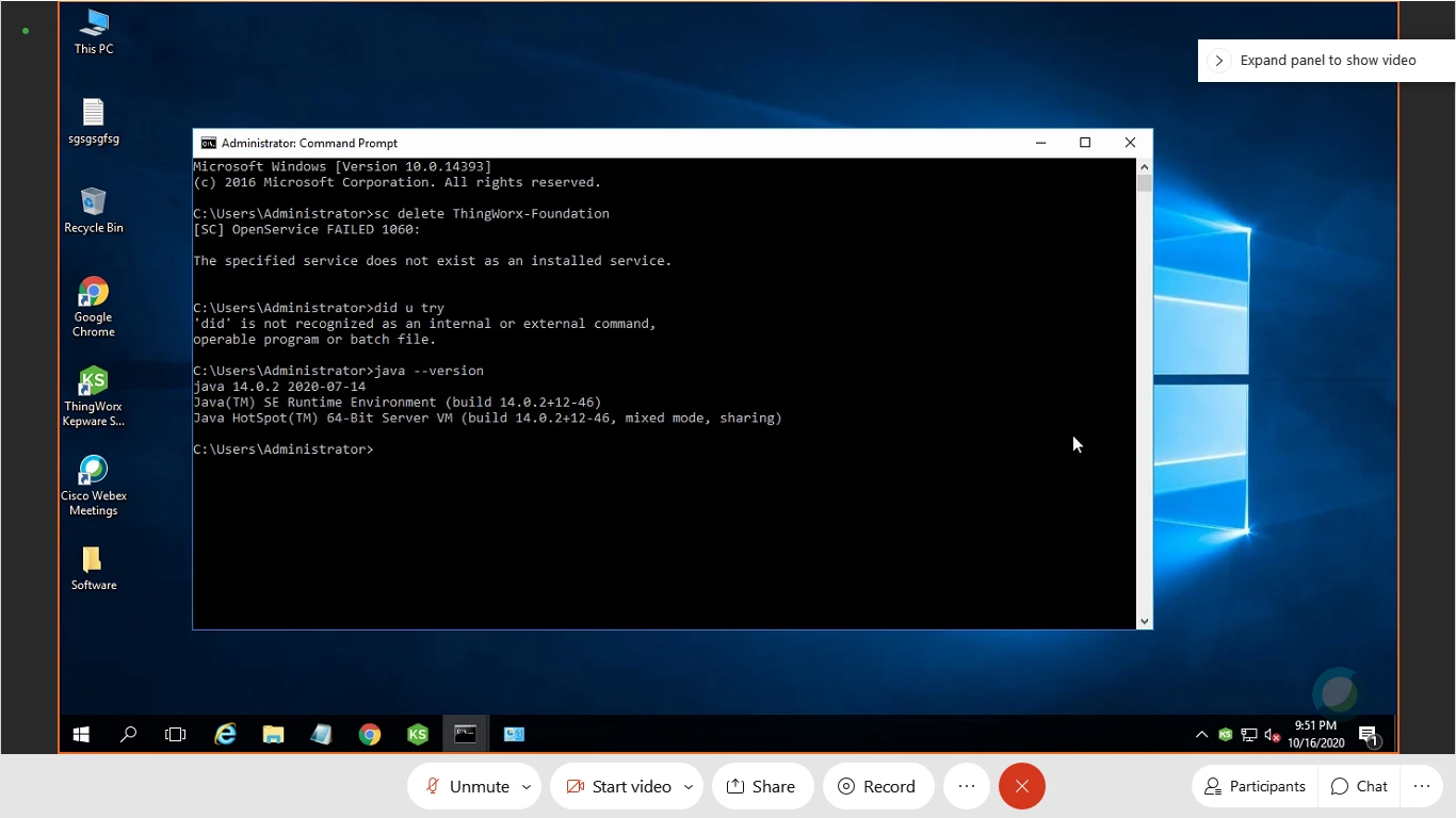

Hi @Sri1.
You are running an unsupported version of java.  We only support java 8.
Please let me know if you have additional issues.

October 16, 2020
Hi @Sri1.
Which version of the Java JDK was installed?  Did you validate the system requirements before running the installer?

Hi Sharon,
Java version: 14.0.2 64-bit (Have attached the image for your reference)
We have meet the system requirements
