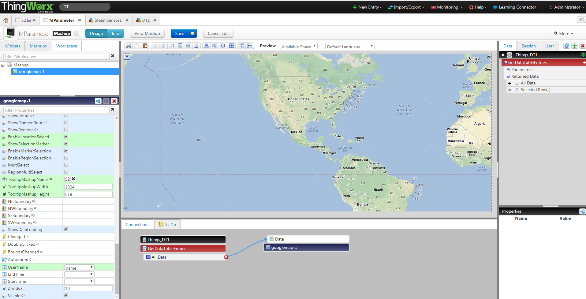

     How do you upload detailed parameters to the linked mashups when you use the "TooltipMashupName" feature on baidu map?

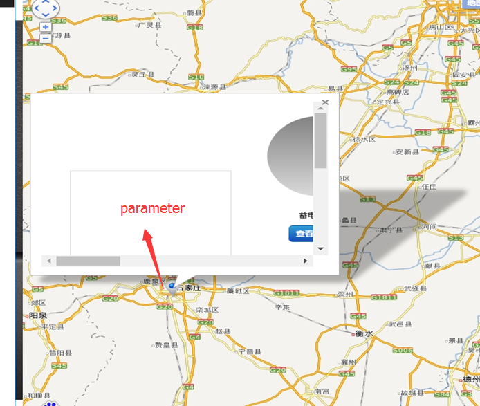

     Look at the picture below,I want to check out the details of the area when I select the area!

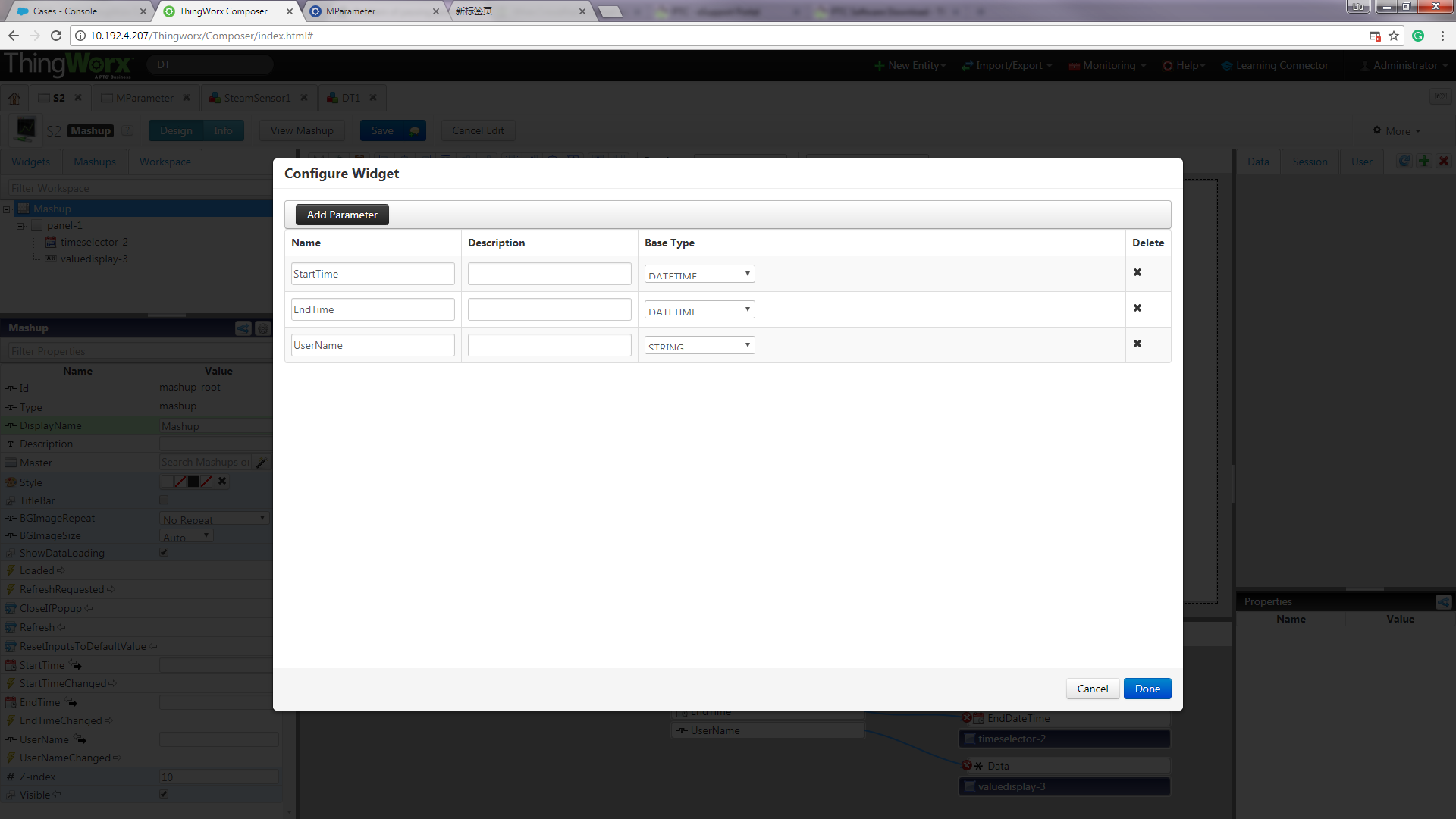

You can create some parameters for the TooltipMashupName bound mashup CellBasicInfo.
For my samples, the bound mashup named S1 and I give it a parameter named UserName
After I set up the parameter click save.
Referesh Map mashup page, and on the bottom of the attribute list there will show up the parameter, please bind your username or machine name to this, then you can see these data on the pop-up mashup.
